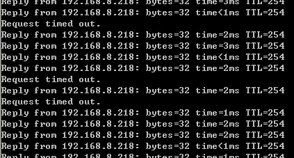

发表于 2011-2-24 17:30:46 | 显示全部楼层 |阅读模式
Reply from 192.168.8.218: bytes=32 time=2ms TTL=254
Reply from 192.168.8.218: bytes=32 time<1ms TTL=254
Request timed out.
Reply from 192.168.8.218: bytes=32 time=1ms TTL=254
Request timed out.
Request timed out.
Request timed out.
